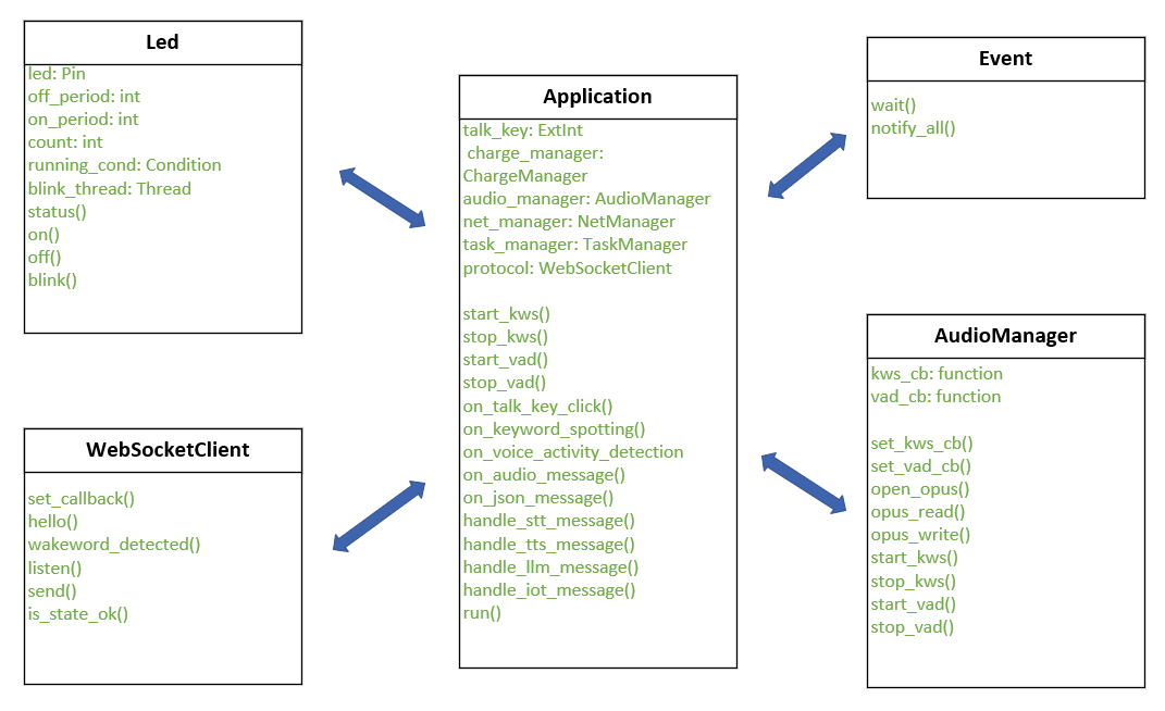

Framework design diagram

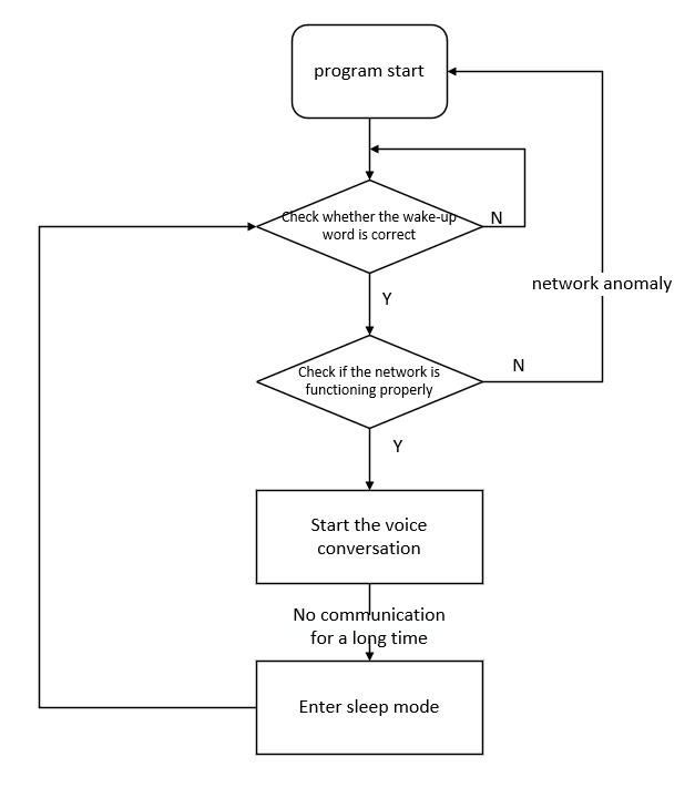

Business system startup process
